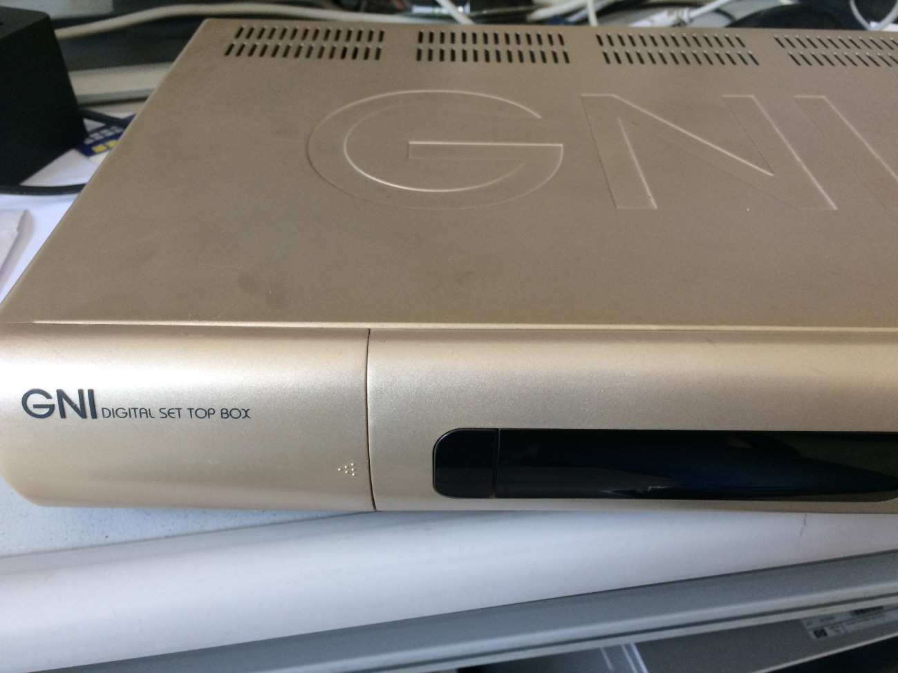

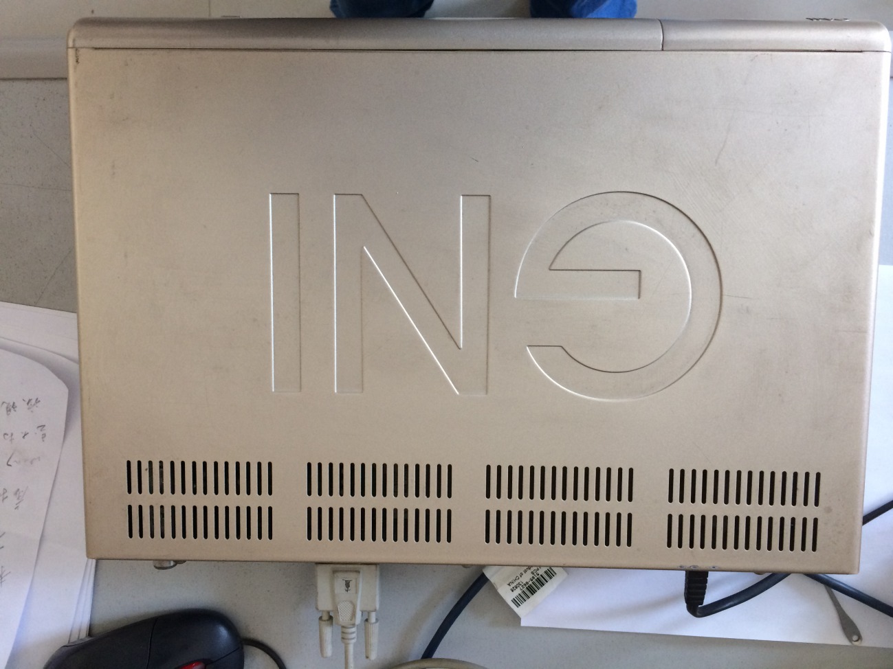

GNI的机顶盒,型号MJD10-50,串口有消息,能搞成开发板玩玩?

Ok
TunerType = DCF8712
M13 Loader Version 1.2.0(nanhai)
building data:Aug 10 2003 time17:02:34
Starting Boot Loader
Run application...
Free Loader Mem
Execute application program!
Set SDRAM Poll!
STAVMEM_Init()=Ok,0xc0000000[0x380000],0x4000,0x0
STAVMEM_CreatePartition()=Ok
STEVT_Init()=Ok
STPWM_Init()=Ok
STI2C_Init(back)=Ok
PTI_Init()=Ok
STCLKRV_Init(CLKRV0)=Ok
STCLKRV_Open(CLKRV0)=Ok
STAUD_Init(AUD0)=Ok
STDENC_Init(DENC0, InvOut 1)=Ok
STVTG_Init(VTG0)=Ok
STVID_Init(VID0)=Ok
STE2P_Init(EEPROM)=Ok
initterm.c, 1341     Info> Report module is initialized ...
ScrnParams.FrameRate = [50]
Anti flicker filter enabLED
   Fixbug.c, 0216     Info>     STOSD_Create dummy Region 4bpp
Creating Application Message queues...
LTV OS initialise...
LTV OS initialise OK.
LTV NVM initialise...
E2P_INIT_DATA:Blk[0]-[nvm_control][0x0] --- register.
E2P_INIT_DATA:Blk[1]-[nvm_ld_inf][0x2c] --- register.
E2P_INIT_DATA:Blk[2]-[nvm_irdeto][0xbc] --- register.
E2P_INIT_DATA:Blk[3]-[nv_idt_db][0x2d0] ---   ok.
E2P_INIT_DATA:Blk[4]-[box_inf][0x364] ---   ok.
E2P_INIT_DATA:Blk[5]-[app_cfg][0x398] ---   ok.
E2P_INIT_DATA:Blk[6]-[nvm_parent][0x468] ---   ok.
block_used = 7,bytes_used = 1164
LTV NVM initialise  OK.
LTV GRAPH Initialise …
LTV GRAPH Initialise OK.
LTV INPUT Initialise...
LTV DEP Initialise OK in LTV_DEP_Initialise.
Initializing UART3!
Initialized UART3 Sucessed!!!
Initializing SmartCard!
Initialization SmartCard Sucessed!!!
Main Smart Card Init successed!
Open SmartCard Sucessed!
SC_SC_Initialise Main Smart Card Init Over !
enter OS init CTI !
enter NV_DRV_Initialise !
IRDETO SECTION FILTER Driver
Creating IRDETO SFILTER MONITOR Process
NO_OF_IRDETO_FILTERS equal to 20
Succesfully Installed IRDETO SFILTER module
SC_DRV_Initialise enter SC init CTI !
SCELL_Ret_Value: 0
SECTION FILTER Driver version[3.0]
Creating SFILTER MONITOR Process
NO_OF_SIMULTANEOUS_FILTERS equal to 8
Succesfully Installed SFILTER module
Initialise Timer Module Begin in LTV_TIMER_Initialise!
Initialise Timer Module Succeed in LTV_TIMER_Initialise!
Begin initialise system message module……
Initialise system message module success!
GNI SECTION FILTER Driver
Creating GNI SFILTER MONITOR Process
NO_OF_GNI_FILTERS equal to 20
Succesfully Installed GNI SFILTER module
GNI: SECT_REQ=> Slot [0]
GNI: SECT_REQ=> Slot [1]
Flash data:  nvm_xpdr_db[6660]
Flash data:  nvm_prg_db[33320]
Flash data:  idto_mail[2604]
Block count[3]
GNI: SECT_REQ=> Slot [2]
uiByteUsed = 42652[0xa69c]
LTV NVM access for(box_inf) ok.
GNI: SECT_REQ=> Slot [3]
LTV NVM access for(app_cfg) ok.
LTV NVM access for(nvm_parent) ok.
GNI: SECT_REQ=> Slot [4]
Get [nvm_xpdr_db] data.
transponder Initialisation: OK
Get [nvm_prg_db] data.
program Initialisation: OK
Get [idto_mail] data.
DATABASE Driver version[1.1c]
TUNER (STV0297) Module Initialisation ver[1.0Beta]
Creating TUNER module semaphores ...
The Tuner type is DCF8712!
Switch to channel[31]
Get Op_Code [0x2]
Freq => Req[347000] Ret[347000]
TIDLE => left idle state
Set spectrum[ON]
pidCurVideo[0x598]!
pidCurAudio[0x599]!
pidCurPcr  [0x597]!
CA MPEG enable
STATUS Message
GNI: SECT_REQ=> Slot [5]
CA MPEG-------------
pvSC_Notify(1, CARD_IN)
App Status: Smart Card verifying
STATUS Message
Get Op_Code [0x10]
Get Op_Code [0x10]
Get Op_Code [0x10]
Get Op_Code [0x10]
******* unlock(347000)******
Set spectrum[ON]
Get Op_Code [0x1]
System id=[606]
CHN
Nationality Code changed !
GetServiceDefine
STATUS Message
System id=[606]
GetServiceDefine
Get Op_Code [0x2]
Set spectrum[ON]
