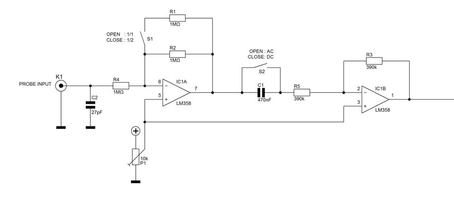

用来做玩具不错,可以看看频率不是太高的波形
按键的连接方式
sbit msUp =P3^7;
sbit msDwn=P3^4;
sbit YposUp=P3^6;
sbit YposDwn=P3^3;
sbit freeze=P3^5;
12864的连接方式
#define data_port P2     //LCD128*64 I/O 信号管脚
sbit    lcdrs =P0^7;      // LCD's RS pin is connected to Pin0 of AVR
sbit    lcdrw =P0^6;      // LCD's r/w pin is connected to Pin1 of AVR
sbit    lcde   =P0^5;      // LCD's e pin is connected to Pin2 of AVR
sbit    lcdcs1 =P0^2;      // LCD's CS1 pin is connected to Pin5 of AVR
sbit    lcdcs2 =P0^1;      // LCD's CS2 pin is connected to Pin4 of AVR
sbit    lcdrst  = P0^0;     // LCD's RST pin is connected to Pin3 of AVR
SCHEMATIC_副本.jpg LM358部分电路
晶振用的是22.1184m的,

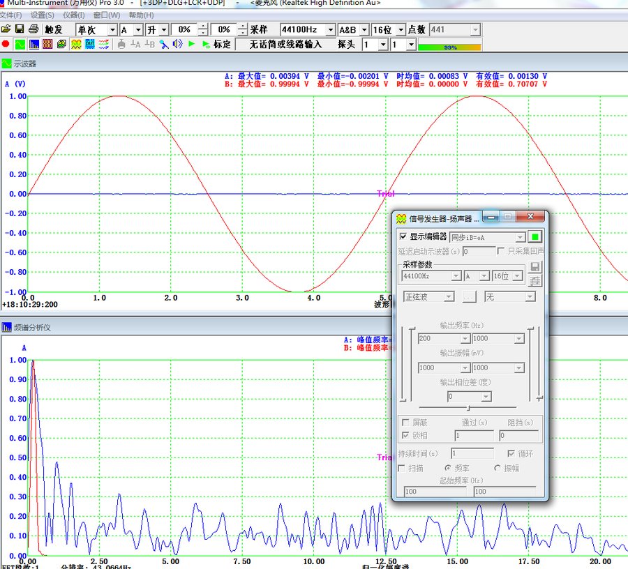

精度还算是不错
400hz
1000hz
500hz
200hz
100hz
50hz
界面有换掉(图中的的还没换)

老大,这个做频率计行不,筛选32768晶振用
 楼主| 发表于 2012-5-23 12:35 | 显示全部楼层
gw168sh 发表于 2012-5-23 10:56 https://www.yleee.com.cn/images/common/back.gif
    不行,超过800hz就不行了,到1000hz就显示1020hz
