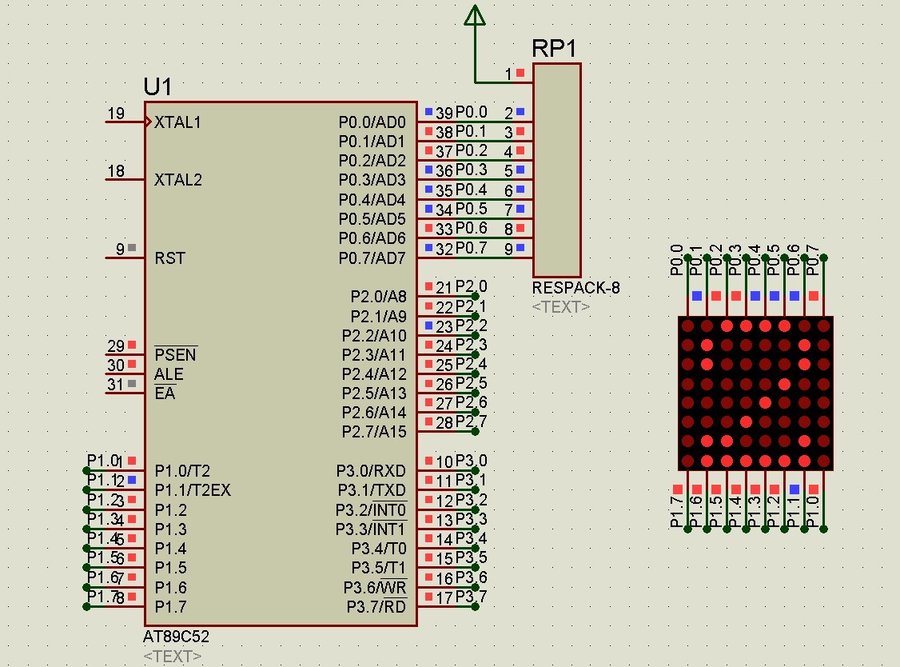

学写LED点阵程序,遇到一个小问题,特来发帖求解:
如下代码,一个code表格中含有多个子code表格,如果我需要随意调出子表格来用,写出一个“向点阵写入一个任意字符“的子函数,该怎么写呢?
#include<reg52.h>
#define uchar unsigned char
#define uint unsigned int
#define hang P1   //定义行数据为P0
#define lie P0   //定义列数据为P1
uchar code dis0[]={0x3C,0x42,0x42,0x20,0x10,0x08,0x46,0x7E};/*"0",9*/
uchar code dis8[][8]={
{0x3C,0x24,0x42,0x42,0x42,0x42,0x24,0x3C},/*"0",9*/
{0x08,0x0E,0x08,0x08,0x08,0x08,0x08,0x3E},/*"1",0*/
{0x3C,0x42,0x42,0x20,0x10,0x08,0x46,0x7E},/*"2",1*/
{0x3C,0x42,0x40,0x38,0x40,0x40,0x42,0x3C},/*"3",2*/
{0x30,0x28,0x24,0x22,0x22,0x3C,0x20,0x30},/*"4",3*/
{0x7E,0x02,0x02,0x3E,0x40,0x40,0x42,0x3C},/*"5",4*/
{0x38,0x24,0x02,0x3A,0x46,0x42,0x46,0x3C},/*"6",5*/
{0x7E,0x22,0x10,0x10,0x08,0x08,0x08,0x08},/*"7",6*/
{0x3C,0x42,0x42,0x2C,0x34,0x42,0x42,0x3C},/*"8",7*/
{0x18,0x26,0x42,0x62,0x5C,0x40,0x24,0x3C},/*"9",8*/

发表于 2012-6-13 23:58 | 显示全部楼层
void  disp(uchar a)
{uchar i;
for(i=0;i<8;i++)
  lie=dis8[a][i];
   hang=dis_x[i];
   delay(2);
   hang=0xff;
void main(void)
uchar i;
while(1)
  for(i=0;i<10;i++)
  disp(i);
当然也可以用指针。
 楼主| 发表于 2012-6-14 08:17 | 显示全部楼层
谢楼上指点,按楼上思路,已经修改完成,再请教下,如果用指针该怎么写呢?对指针的用法还不太懂
//向点阵写入一个数字-------------------------------------------
void write_dat(uchar dat)
        uchar i;
        for(i=0;i<8;i++)
                        lie=dis8[dat][i];
                        hang=dis_x[i];
                        delay(1);
                        hang=0xff;
void main()
        uint i,a;
        while(1)
                for(i=0;i<10;i++)
                        for(a=50;a>0;a--)
                                write_dat(i);
发表于 2012-6-14 10:45 | 显示全部楼层
去学习一下数组。指针你可以理解为存放数据的地址
