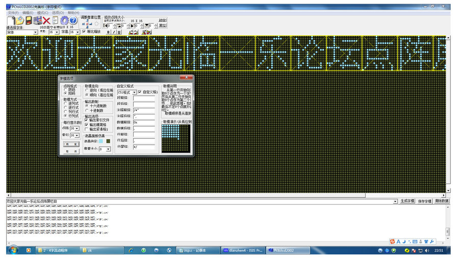

    shqi2003  版主您好,我用PCtoLCD2002取字模取的“欢迎大家”几个字对比一下您给的程序里面的字模不对,请问是如图设置的吗!?
以下是我取的,不知道哪里不对,请指教一下!!!
{0xFF,0xFE,0xFF,0xFE,0xC0,0xFE,0x5F,0x80,0x5E,0xDF,0xAD,0xED,0xEB,0xFD,0xF7,0xFD},
{0xE7,0xFD,0xE7,0xF9,0xDB,0xFA,0xDB,0xF6,0x7D,0xE7,0x9E,0x8F,0xE3,0xDF,0xFF,0xFF},/*"欢",0*/
{0xFD,0xFF,0x7B,0xFE,0x93,0xC1,0xDB,0xDD,0xDF,0xDD,0xDF,0xDD,0xD8,0xDD,0xDB,0xDD},
{0x5B,0xDD,0x9B,0xD5,0xDB,0xED,0xFB,0xFD,0xFB,0xFD,0xF5,0xFF,0x0E,0x80,0xFF,0xFF},/*"迎",1*/
{0x7F,0xFF,0x7F,0xFF,0x7F,0xFF,0x7F,0xFF,0x7F,0xFF,0x00,0x80,0x7F,0xFF,0xBF,0xFE},
{0xBF,0xFE,0xBF,0xFD,0xDF,0xFD,0xDF,0xFB,0xEF,0xF7,0xF7,0xE7,0xFB,0x8F,0xFD,0xDF},/*"大",2*/
{0xBF,0xFF,0x7F,0xFF,0x03,0x80,0xFD,0xDF,0x05,0xE8,0x7F,0xFF,0xBF,0xFF,0x0F,0xFB},
{0xB1,0xF2,0xDF,0xFC,0x67,0xFC,0x99,0xF2,0xE7,0x8E,0xF9,0xDE,0x5F,0xFF,0xBF,0xFF},/*"家",3*/

发表于 2012-10-11 00:18 | 显示全部楼层
因为是以前玩的,找到了以前一个提示,不过还要把上下字模调换一下,或者你自己再研究一下。
比如这个方式取模是
{0xFF,0xFF,0x03,0xFB,0xFA,0xB6,0xD5,0xEB,0xEF,0xD7,0xDB,0xBA,0x7E,0xFD,0xFB,0xF7},-----------这个放在下面来就OK了。
{0x7F,0x7F,0x7F,0x03,0xFB,0xF7,0xBF,0xBF,0xBF,0x5F,0x5F,0xEF,0xEF,0xF7,0xFB,0xFD},/*"欢",0*/
