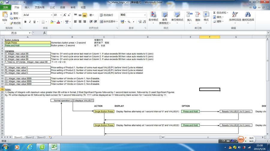

大家好,找了个一个按键 能实现长短按键的逻辑功能图,看了半天没有怎么看明白吧。不会写代码,怎样实现图中的功能, 贴上来,请大家给讲解下,谢谢大家了。
自己试着摸索些了部分代码,可好像没有实现图中的功能,请哪位网友给讲讲。

自己练习的部分代码:
*        2013.05.22
// #include "STC12C2052AD.H"
// #include <regX52.h>
#include "STC15F2K08S2.H"
#include <intrins.h>
#define uchar unsigned char
#define uint  unsigned int
#define led_1_close LED_1 = 0;
#define led_1_open  LED_1 = 1;
#define led_2_close LED_2 = 0;
#define led_2_open  LED_2 = 1;
#define delay_number   25  //按键去抖动延时阀值
// sbit led0 = P1^0;                //LED 发光二极管
sbit led0 = P1^1;
// sbit led2 = P1^2;
sbit led1 = P2^1;
sbit led2 = P2^2;
sbit Func_key_in = P3^2;
sbit LED_1 = P2^6;        //正视左边第一个数码管位选
sbit LED_2 = P2^7;        //正视右边第一个数码管位选
bit bit_1s;
bit bwei;
const unsigned char code LED_SEG[]={0xc0,0xf9,0xa4,0xb0,0x99,0x92,0x82,0xf8,0x80,0x90,};//0-9
//数码管:正向位置;共阳极;正向连接
const unsigned char code Segment_7code[]={0xC0,0xF9,0xA4,0xB0,0x99,0x92,0x82,0xF8,0x80,0x90,0x88,
                                                                                                                                                                        0x83,0xC6,0xA1,0x86,0x8E,0xFF};//0-9,A-F,灭
                                                                                                                                                                         P -> 0x8c,t -> 0x87,C -> 0xc6,c -> 0xa7,
unsigned char key_lock1,Counter = 99;
unsigned char time_10ms,time_100ms,time_300ms,buffer[2];
unsigned char key_step,key_value;/*keyvalue == 8*/
unsigned char t1_value,t2_value,t3_value,T;
unsigned char P1_value,P2_value,P3_value;  //Product1,
unsigned int delay_cnt1;
unsigned int C1,C2,C3;
void DelayMs(uint x);
void key_scan()                                //按键扫描函数
        Func_key_in = 1;        //置1 输入,准备读入按键
  if(Func_key_in == 1)    //IO是高电平,说明按键没有被按下,这时要及时清零一些标志位
                key_lock1 = 0;
                delay_cnt1 = 0;
        else if(Func_key_in == 0)
   ++delay_cnt1;  //延时计数器
   if(delay_cnt1 > delay_number)
                        delay_cnt1 = 0;
                        key_lock1 = 1;
      key_value = 1;         //触发1号键
                        key_step++;
                        if(key_step > 6){ //4
                                key_step = 0;
void key_process()
        switch(key_step)
                case 1:
                        if(bit_1s){
                        P0 = 0x87;//t
                        P26 = 0;
                        DelayMs(2);
                        P26 = 1;
                        P0 = Segment_7code[1];         //1
                        P27 = 0;
                        DelayMs(2);
                        P27 = 1;
                        }else{
                        P0 = Segment_7code[2];
                        P26 = 0;
                        DelayMs(2);
                        P26 = 1;
                        P0 = Segment_7code[6];         //1
                        P27 = 0;
                        DelayMs(2);
                        P27 = 1;
                break;
                case 2:
                        P0 = 0x87;//t
                        P26 = 0;
                        DelayMs(2);
                        P26 = 1;
                        P27 = 0;
                        DelayMs(2);
                        P27 = 1;
                        break;
                case 3:
                        P0 = 0x87;//t
                        P26 = 0;
                        DelayMs(2);
                        P26 = 1;
                        P0 = Segment_7code[3];         //1
                        P27 = 0;
                        DelayMs(2);
                        P27 = 1;
                        break;
                case 4:
                        P0 = 0x8c;//t
                        P26 = 0;
                        DelayMs(2);
                        P26 = 1;
                        P27 = 0;
                        DelayMs(2);
                        P27 = 1;
                        break;
                case 5:
                        P0 = 0x8c;//t
                        P26 = 0;
                        DelayMs(2);
                        P26 = 1;
                        P0 = Segment_7code[2];         //1
                        P27 = 0;
                        DelayMs(2);
                        P27 = 1;
                        break;
                case 6:
                        P0 = 0x8c;//t
                        P26 = 0;
                        DelayMs(2);
                        P26 = 1;
                        P27 = 0;
                        DelayMs(2);
                        P27 = 1;
                        break;
                case 7:
                        P0 = 0xff;
                        break;
                default:
                        break;
        uchar t;
        while(x--)
                 for(t=120;t>0;t--);
void timer0_ser() interrupt 1{
        static unsigned char t;
        TR0 = 0;
        TH0 = (65536 - 50000) / 256;
        TL0 = (65536 - 50000) % 256;
        t++;
        if(t >= 20){        //50ms*20=1s
                t = 0;
//                 bit_1s = 1;
                bit_1s = ~bit_1s;
                led0 = ~led0;
                 Counter--;
                if(Counter <= 0){
                        Counter = 99;
        TR0 = 1;
void display_data(){
        P0 = buffer[1];
        P26 = 1;
        DelayMs(2);
        P26 = 0;
        P0 = buffer[0];
        P27 = 1;
        DelayMs(2);
        P27 = 0;
void timer1_ser(void)interrupt 3
        TR1 = 0;
        TH1 = 0Xf8;                //2ms value
        TL1 = 0Xcd;
        time_10ms++;
        //2ms 定时中断到了,这里显示数码管驱动
        if(time_10ms >=5){
                time_10ms = 0;
                key_scan();        //10MS 到了 定时扫描按键
        time_100ms++;
        if(time_100ms >= 50){//100ms flash
                time_100ms = 0;
                led1 = ~led1;
                time_300ms++;
                if(time_300ms >= 3){//300ms flash
                        time_300ms = 0;
                        led2 = ~led2;
        TR1 = 1;
void main(void)
        TMOD |= 0x11;        //        timer 0 and timer1 mode 1 16bit
        TH1        =        0Xf8;                                 //2ms  11.0592M
        TL1        =        0Xcd;
        TR0 = 1;
        ET0 = 1;
        TR1 = 1;
        ET1 = 1;
        EA  = 1;
        P26 = 1;
        P27 = 1;
        while(1)
                key_process();
//                  numberToBuffer();
//                 display_data();

昨天调试了,没有实现效果呀。长短按效果。
