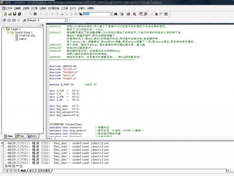

发表于 2010-9-16 21:12 | 显示全部楼层
发表于 2010-9-16 21:32 | 显示全部楼层
检查一下分号是不是用了全角的。等号空格一下看看 如:sbit Key_add = p3^7;
发表于 2010-9-16 21:36 | 显示全部楼层
twtarm 发表于 2010-9-16 21:32 https://www.yleee.com.cn/images/common/back.gif
    #include <REGX52.H>
#include "DS1302.h"
#include "DS18B20.h"
#include "ascii.h"
#include "nongli.h"
#define H_PORT P0       //ABCD P0
sbit L_CLK =  P2^0;
sbit L_D  =  P2^2;
sbit L_STB  =  P2^1;
sbit L_OE   =  P2^3;
sbit Key_add= P3^7;
sbit Key_dec= P3^5;
sbit Key_adjust=P3^6;
sbit Key_cancel=P3^4;
SYSTEMTIME CurrentTime;
unsigned char status=0;   //按键状态
unsigned char disp_mode=0;  //显示状态  0:移动 1:时间 2:温度??
unsigned char offset=0;      //移动显示用的变量
unsigned char disrow=0;   //当前扫描行
unsigned char k=0;    //往buff中填的字
unsigned int  t_counter=0,stop_counter=0,stop_time=0;
unsigned char f1=0,f2=0,f3=0,f4=0,f5=0,f6=0;
bit switch_flag=0,stop_bit=0;
bit one_min_flag=0,half_min_flag;
bit nongli_flag=0,nongli_change_flag=0;
unsigned char T_int,T_dec;  //计算温度用。
unsigned char temp_time[6];
unsigned char code mode[4]={0,1,7,8}; //几种显示模式的排列,依次为
                                     //0:流动显示年月日+固定一段时间翻页钟
                                     //1:翻页钟
                                     //7:全部流动显示
                                     //8:温度
这样对吗?
