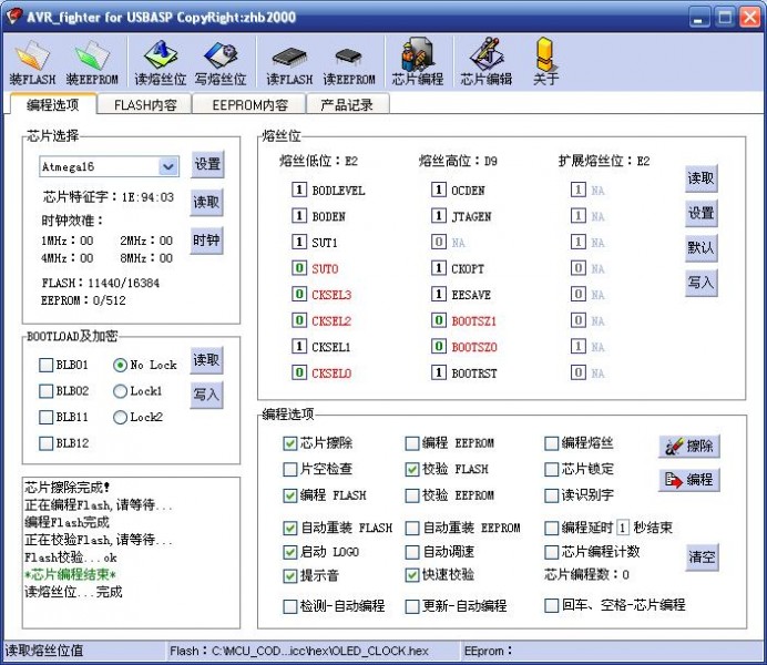

1.mega16的熔丝配置
https://www.yleee.com.cn/attachments/forumid_17/20090605_c76d790f9efe4aaa0830C5s4hiD6JeHJ.jpg.thumb.jpg
