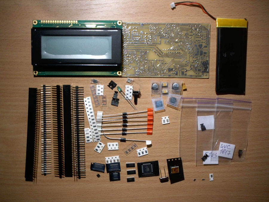

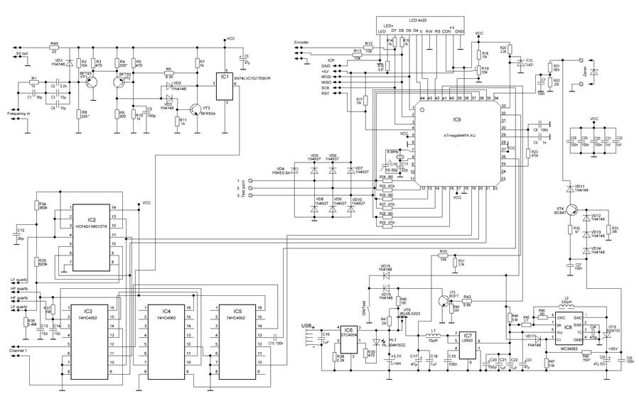

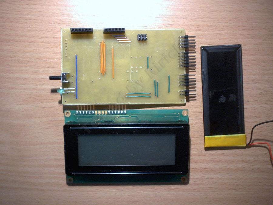

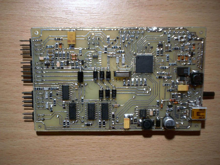

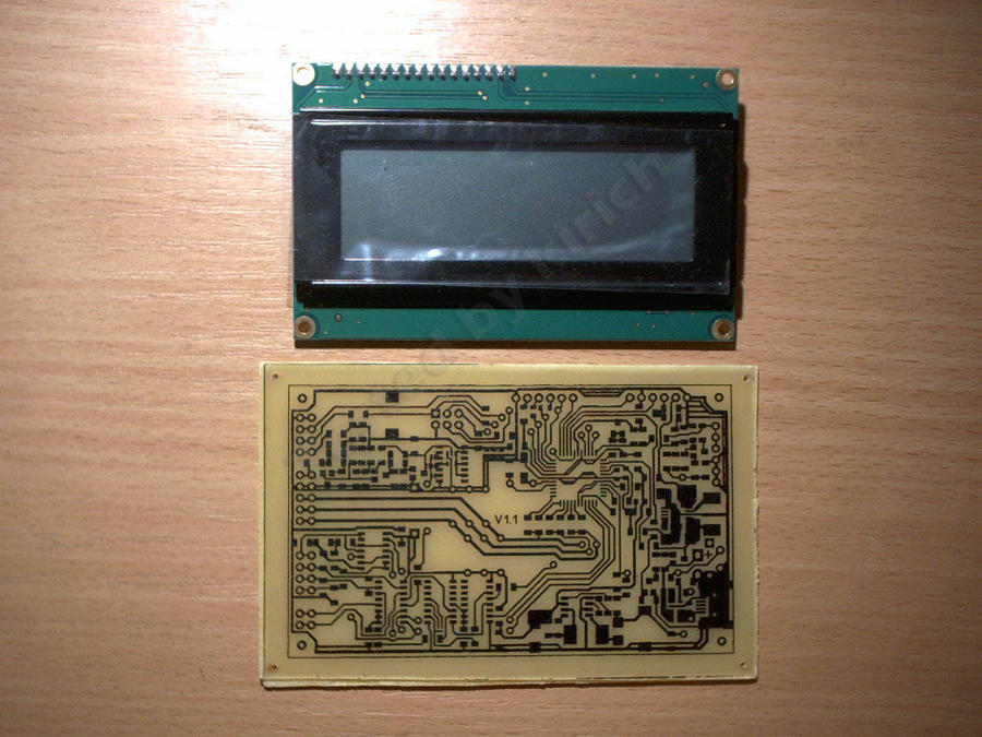

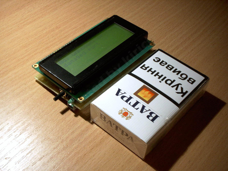

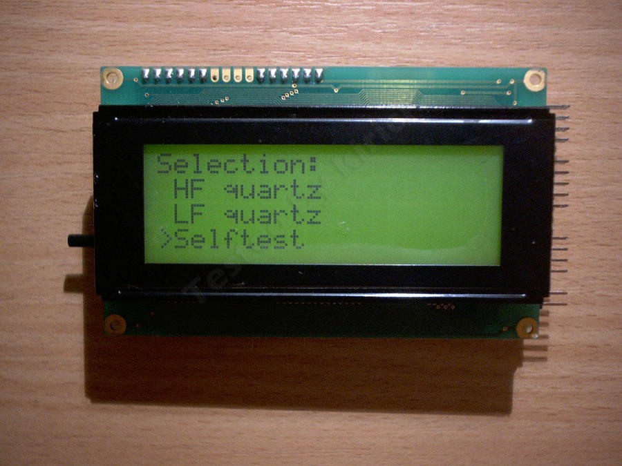

2004 display, Li-ion Battery and charge, Frequency meter, Generator, Little board, Zener meter.
It's a pity that you can not put links :(

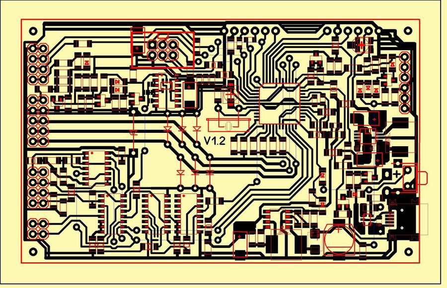

 楼主| 发表于 2015-2-13 00:09 | 显示全部楼层
tplin 发表于 2015-2-12 21:06
好东西啊,PCB能分享下吗?
PCB
Generally the fee is available in two versions, but the second will be difficult for me to describe it changed management boost converter.
Because post the first version of the board, as in the photo above.
universal meter 2004_F3.zip
79.97 KB, 下载次数: 702, 下载积分: 一乐金币 -1
