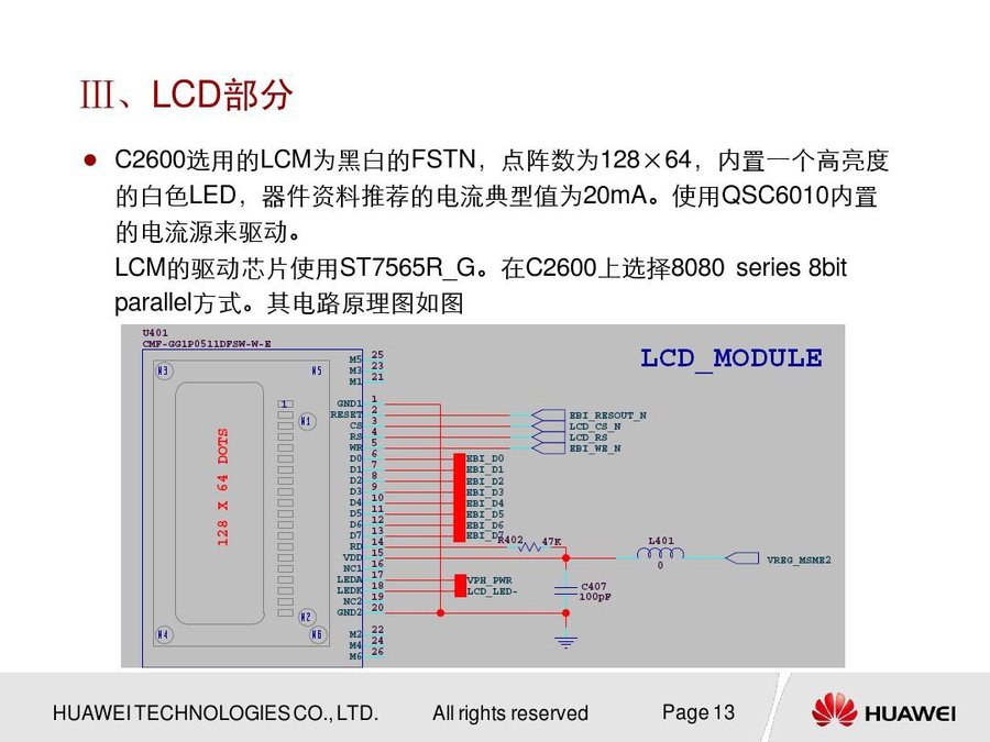

第一款
这一款最早点亮,见帖子:https://www.yleee.com.cn/thread-45565-1-1.html
https://www.yleee.com.cn/data/attachment/forum/201510/01/153931h9jzu8jv8raeuze5.jpg.thumb.jpg
初始化时序:
    LCD_WriteCmd(0xe2);//system reset
    Delayms(50);
    LCD_WriteCmd(0xa2);
    LCD_WriteCmd(0xa0);
    LCD_WriteCmd(0xc8);
    LCD_WriteCmd(0x26);
    LCD_WriteCmd(0x81);
    LCD_WriteCmd(0x20);
    LCD_WriteCmd(0x2f);
    Delayms(50);
    LCD_WriteCmd(0xaf);
    LCD_WriteCmd(0xf8);
    LCD_WriteCmd(0x00);
屏幕显示区域为128*64,上方状态图标在65行。完整程序网上找吧

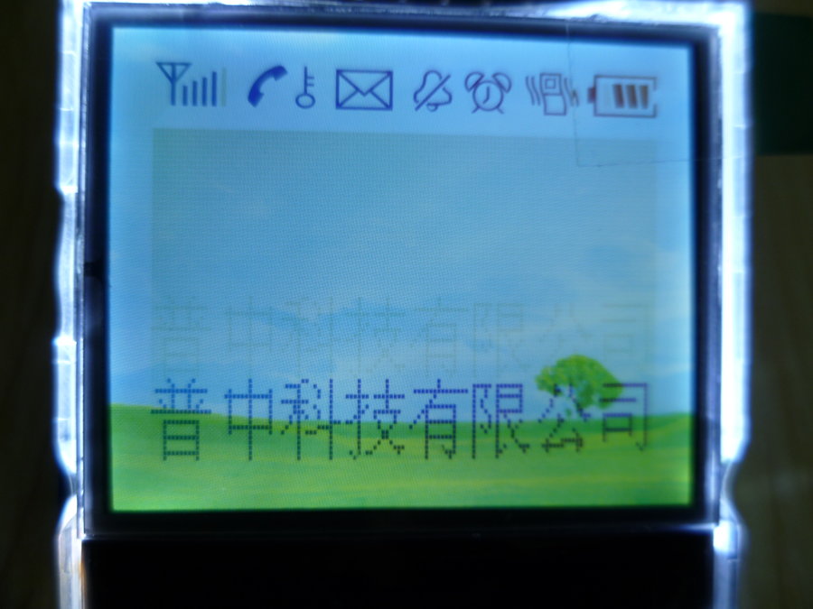

有坛友点亮了传送门 https://www.yleee.com.cn/thread-45602-1-1.html
