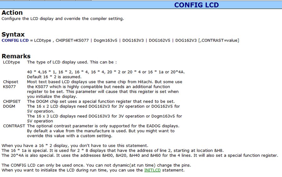

[avr] 请教下M8程序中1602如何修改驱动

这1602第一行也是80h,不过第二行是90h,而不是标准屏的c4h

试了下把原来第2行写到第3行,倒是可以全部显示了,可是显示是镜像的,这个估计只能在初始化中解决

benli 发表于 2016-2-2 12:59
是全部源码,LCD1602好像用的是编译器的库
Syntax
$LCDRS = [&H]address
Remarks
Address        The address where must be written to, to enable the LCD display.The db0-db7 lines of the LCD must be connected to the data lines D0-D7. (or is 4 bit mode, connect only D4-D7)On systems with external RAM, it makes more sense to attach the LCD to the data bus. With an address decoder, you can select the LCD display.
Syntax
$LCD = [&H]address
Remarks
Address        The address where must be written to, to enable the LCD display and the RS line of the LCD display.The db0-db7 lines of the LCD must be connected to the data lines D0-D7. (or is 4 bit mode, connect only D4-D7)The RS line of the LCD can be configured with the LCDRS statement.On systems with external RAM, it makes more sense to attach the LCD to the data bus. With an address decoder, you can select the LCD display.
Do not confuse $LCD with the LCD statement.
添加下面三行试试,地址不对的话修改一下

lcd初始化指令没法修改

把原程序第二行内容送第三行解决了非标屏第2行显示的问题,可是显示镜像的问题没解决,估计得修改初始化命令

显示镜像是整行都镜像,还是每个字符都镜像?如果每行镜像反过来送就可以。

整体的镜像,就像在镜子里看到的,这个屏得多几个初始化命令,算了,不折腾了
