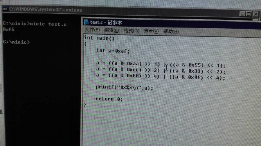

谁在优信买过这种小遥控器,为啥我红外线解码程序读出键码和给出的键码不一致呢?

ain365 发表于 2016-2-29 22:24
楼主你的解码程序有问题,红外编码,低位在前,你读出的码A2反过来正好是45
A2=(10100010), 45=(01000101)
找了个蝶形变化的公式把高低位顺序变换了一下,现在OK了,再次感谢!~
00 FF 45 BA 00 FF 46 B9 00 FF 47 B8
00 FF 44 BB 00 FF 40 BF 00 FF 43 BC
00 FF 07 F8 00 FF 15 EA 00 FF 09 F6
00 FF 16 E9 00 FF 19 E6 00 FF 0D F2
00 FF 0C F3 00 FF 18 E7 00 FF 5E A1
00 FF 08 F7 00 FF 1C E3 00 FF 5A A5
00 FF 42 BD 00 FF 52 AD 00 FF 4A B5
顺便分享下这个蝶形变换的公式,比较有意思:
int main()
    int a=0xaf;
    a = ((a & 0xaa) >> 1) | ((a & 0x55) << 1);
    a = ((a & 0xcc) >> 2) | ((a & 0x33) << 2);
    a = ((a & 0xf0) >> 4) | ((a & 0x0f) << 4);
    printf("0x%x\n",a);
    return 0;
经过测试结果正确:
