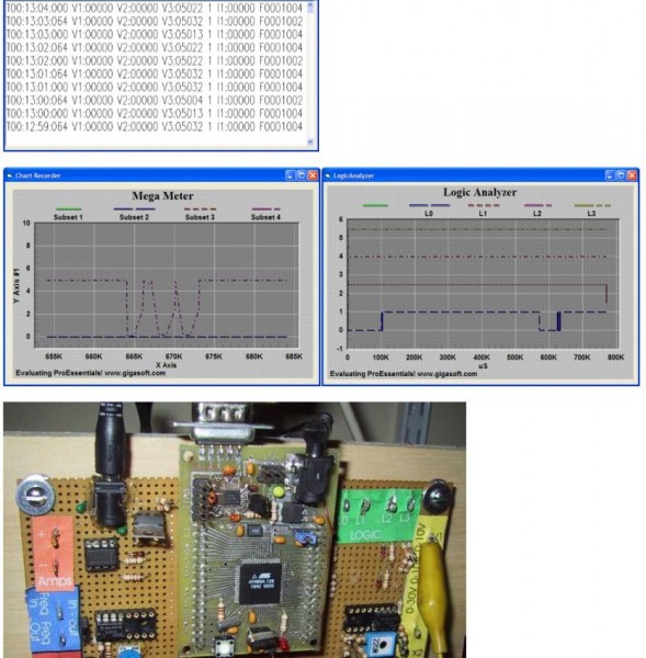

功能:
1.
Two 0 – 10 VDC voltmeters
2.
One 0 – 30 VDC Hi-Z autoranging voltmeter with x10 jumper to give 0 -300 VDC range
3.
0 – 3 Amps high side ammeter
4.
4 channel logic analyzer
5.
Frequency generator – 50% duty cycle square wave, 0 - 5 VDC, uC clock with divider, 1 Hz to about 8 MHz
6.
Waveform generator – sine, triangle, square wave, 1Hz to 20+ MHz
7.
Frequency counter
8.
+5 VDC supply – 200 mA available
9.
-5 VDC supply – 300 mA available
一些图
http://members.shaw.ca/Botgoodies2/MegaMeter/MM_Schematic.gif
作者网点:
http://members.shaw.ca/Botgoodies2/MegaMeter/MegaMeter.htm

好东东啊,不过AVR涨价后,M128贵啊。个人觉得做这种多功能仪器,最好是用MCU控制+专用AD片,这样成本比较低,功能也更强,毕竟便宜的MCU片内AD配置低,一般只有10bit以下的,片内AD好的,MCU又太贵了。
发表于 2011-3-6 22:06 | 显示全部楼层
MAX038~~~很贵啊。。。
AVR去年底就已经降价了,新款的MEGA128A是 29元/PCS
