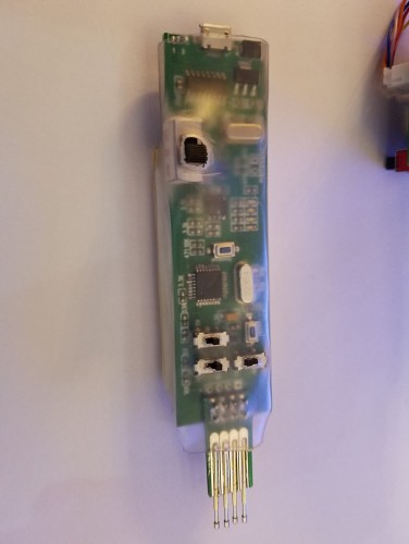

1、STC 单片机充电离线下载笔
     stc一直只能在线下载 固件。后来厂商推出了离线下载器U7、U8。
离线下载器的好处可以批量刷写固件无需电脑。适合小批量生产和现场升级。
但是厂商的离线下载器,使用麻烦。本人在此基础上,开发出离线下载笔,
并在基础上增加了锂电池,真正实现了无线操作。
下图是在板烧写和芯片座烧写。适合stc全部型号(理论上)。
批量烧写板子,就用只笔就行了。
http://bbs.38hot.net/data/attachment/forum/201707/01/234245pddq4rmupmatrw1p.jpg.thumb.jpghttp://bbs.38hot.net/data/attachment/forum/201707/01/234245f9vqgvilhshjdvhq.jpg.thumb.jpghttp://bbs.38hot.net/data/attachment/forum/201707/01/234244xxxbmysxitbymcja.jpg.thumb.jpg http://bbs.38hot.net/data/attachment/forum/201707/01/234243ilbcgii0czl558s5.jpg.thumb.jpg
http://bbs.38hot.net/data/attachment/forum/201707/01/234243vopmvmobmbgb69mo.jpg.thumb.jpg http://bbs.38hot.net/data/attachment/forum/201707/01/234242di6znzkswtw7lfls.jpg.thumb.jpg

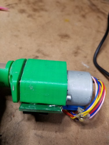

2、充电点锡器
电动点锡器,点锡后的板子可以用风枪或者回流焊。小批量可以代替钢网。
焊接贴片元件 不用电烙铁,非常方便。
http://bbs.38hot.net/data/attachment/forum/201707/01/234246ummdg4ej64eg95dr.jpg.thumb.jpghttp://bbs.38hot.net/data/attachment/forum/201707/01/234246i33pr11r00i4kyl1.jpg.thumb.jpghttp://bbs.38hot.net/data/attachment/forum/201707/01/234247y335tz5j4weebsn3.jpg.thumb.jpghttp://bbs.38hot.net/data/attachment/forum/201707/01/234241oib99u5zqw4oe69i.jpg.thumb.jpg http://bbs.38hot.net/data/attachment/forum/201707/01/234242hllullnlxaia0i9i.jpg.thumb.jpghttp://bbs.38hot.net/data/attachment/forum/201707/01/234241pu2epnhytfa8anla.jpg.thumb.jpg http://bbs.38hot.net/data/attachment/forum/201707/01/234241tkttuzkmmck5slpr.jpg.thumb.jpghttp://bbs.38hot.net/data/attachment/forum/201707/01/234240cgezm3752yy0uyey.jpg.thumb.jpg http://bbs.38hot.net/data/attachment/forum/201707/01/234240vzcv4tzy5cce4tac.jpg.thumb.jpghttp://bbs.38hot.net/data/attachment/forum/201707/01/234239orcwb4h6rjzc7r4s.jpg.thumb.jpg http://bbs.38hot.net/data/attachment/forum/201707/01/234238l64jqa184548ja66.jpg.thumb.jpg
