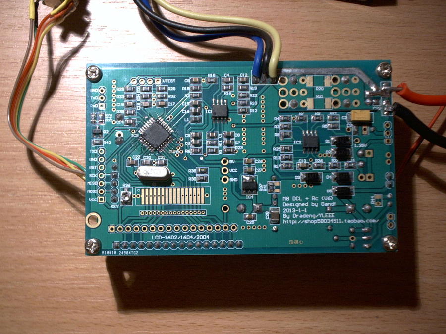

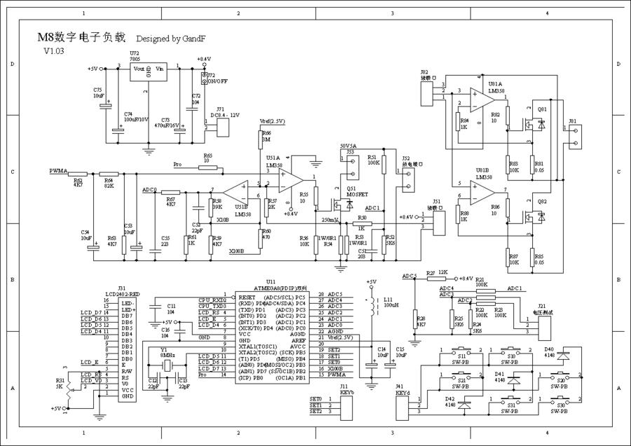

How do you get a 15 amp current electronic load M8?
I processor regulates only up to 5 Amps, on the display can be set 5-15 amps, but the current does not change.
Does not change the voltage PWM.
Tell me what you did, please. I saw a scheme where two connected transistor and operational amplifier, but in fact if it is connected, the processor will not allow to do 15 amps.
Tried to install the firmware on the 15 Amp (on the first page), but I have a 2004 and the indicator lines are indented.
Just adjust the display to 15, but the voltage to the transistor varies only in the range of 0-7.5 Ampere.
The first firmware update -
0-5 Amps
0-0.25 volts
5-15 Amps
0.25-0.25 V
The second firmware
0-7.5 Amps
0-0.25 volts
7.5 - 15 Amp
0.25-0.25 V
I download the source code can not, because asking the community to help in this task. It turns out that I have to - 0-15 Amps 0-0.25 volts
I was planning to use the following amplification circuit current -
I have the board -
