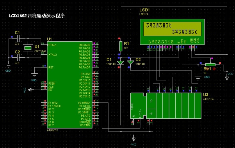

硬件参考了论坛倪老师的,在此说声感谢!有汇编源码和仿真文件      org 0000h

  ajmp $

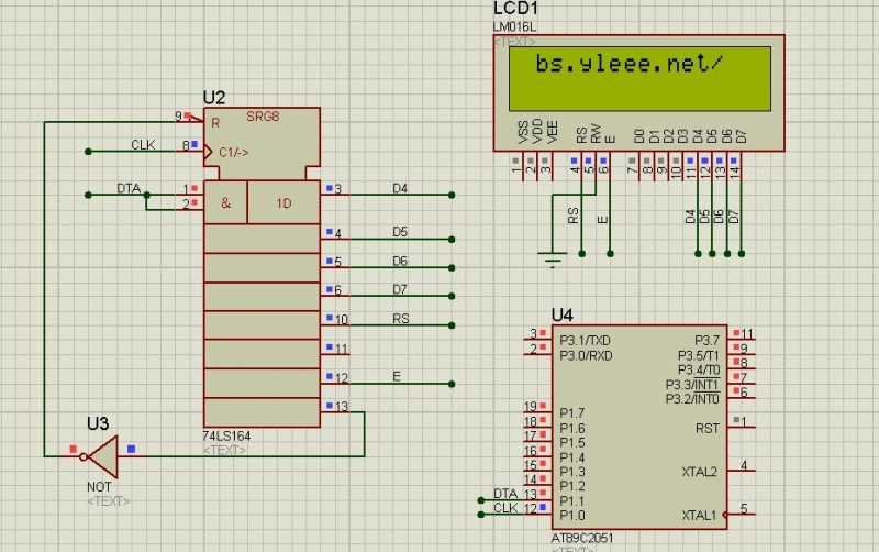

CLKLCD equ p1.0
DATALCD equ p1.1
LCDDELAY equ 40
   org 0h
   acall INITLCD
   ;https://www.yleee.com.cn/
m1:  mov acc,#'b'
   acall LCD_DAT

INITLCD:

LCD_COM:  clr CLKLCD
   acall wait
   push acc
   swap a ;D7...D4
   anl a,#0fh
   orl a,#80h ;command
   acall send8
   pop acc ;D3...D0
   anl a,#0fh
   orl a,#80h
   acall SEND8
   ret
LCD_DAT:  clr CLKLCD
   acall wait
   push acc
   swap a ;D7...D4 send
   anl a,#0fh
   orl a,#90h ;command
   acall send8
   pop acc ;D3...D0
   anl a,#0fh
   orl a,#90h
   acall SEND8
   ret
SEND8:  mov r7,#8
RLCA:   rlc a
   mov DATALCD,c
   setb CLKLCD
   clr CLKLCD
   djnz r7,RLCA
   ret

 楼主| 发表于 2011-5-10 07:55 | 显示全部楼层
谢谢倪版!
发表于 2011-5-12 09:48 | 显示全部楼层
回复 6# 倪大德
    U3是什么?能弄个C语言的不?
