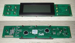

3元的LCD2004 截短改造成功

引脚定义完全兼容1602,引脚定义为:
1.GND 2.VDD 3.VO 4.RS 5.R/W 6.E 7-14.DB0-DB7
http://img08.taobaocdn.com/imgextra/i8/188853303/T2NixeXi6j4tNXXXXX_!!188853303.jpg
背光5伏,从这里引出:
http://img08.taobaocdn.com/imgextra/i8/188853303/T2pLRdXabhsdNXXXXX_!!188853303.jpg
