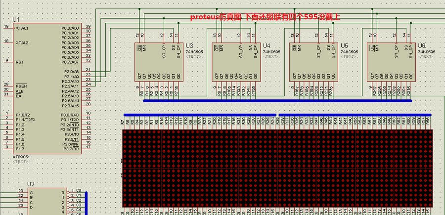

求16x64左移程序纠错 麻烦各位老师看一下

#include <reg52.h>
#define uchar unsigned char
sbit ds=P2^0;
sbit shcp=P2^1;
sbit stcp=P2^2;
sbit hc595_oe=P2^3;
void ser_in(uchar data_ds);
void par_out();
uchar code tab[]={
0x00,0x20,0x04,0x20,0x04,0x20,0x04,0x20,0x04,0x20,0x04,0x20,0x04,0x20,0xFC,0x3F,
0x04,0x20,0x04,0x20,0x04,0x20,0x04,0x20,0x06,0x20,0x04,0x30,0x00,0x20,0x00,0x00,//工
0x00,0x40,0x10,0x40,0x60,0x40,0x80,0x47,0x00,0x40,0xFF,0x7F,0x00,0x40,0x00,0x40,
0x00,0x40,0xFF,0x7F,0x00,0x44,0x00,0x43,0xC0,0x40,0x30,0x60,0x00,0x40,0x00,0x00,//业
0x40,0x04,0x30,0x04,0x11,0x04,0x96,0x04,0x90,0x04,0x90,0x44,0x91,0x84,0x96,0x7E,
0x90,0x06,0x90,0x05,0x98,0x04,0x14,0x04,0x13,0x04,0x50,0x06,0x30,0x04,0x00,0x00,//学
0x00,0x00,0xFE,0xFF,0x22,0x04,0x5A,0x08,0x96,0x87,0x0C,0x81,0x24,0x41,0x24,0x31,
0x25,0x0F,0x26,0x01,0x24,0x3F,0x34,0x41,0xA4,0x41,0x14,0x41,0x0C,0x70,0x00,0x00};//院
void main()
int y,k;
hc595_oe=0;
while(1)
  for(y=0;y<50;y++)
   for(k=0;k<16;k++)
     ser_in(tab[2*k]);
     ser_in(tab[2*k+1]);
     ser_in(tab[2*k+32]);
     ser_in(tab[2*k+33]);
     ser_in(tab[2*k+64]);
     ser_in(tab[2*k+65]);
     ser_in(tab[2*k+96]);
     ser_in(tab[2*k+97]);
     P1=k+1;
     par_out();
uchar i;
for(i=0;i<8;i++)
  shcp=0;
  data_ds=data_ds&0x80;
  data_ds<<1;
  shcp=1;
void par_out()
stcp=0;
stcp=1;

 楼主| 发表于 2011-10-29 21:53 | 显示全部楼层
仿真后屏全亮了
 楼主| 发表于 2011-10-29 21:55 | 显示全部楼层
想实现“工业学院”四个字左移循环显示  但仿真后屏全亮了
发表于 2011-10-29 22:06 | 显示全部楼层
发送完一行以后,延时1ms左右看看.
左移右移的话, 字符前,字符后 发送几个空白数据就可以了.

 楼主| 发表于 2011-10-29 23:38 | 显示全部楼层
这是仿真源文件
