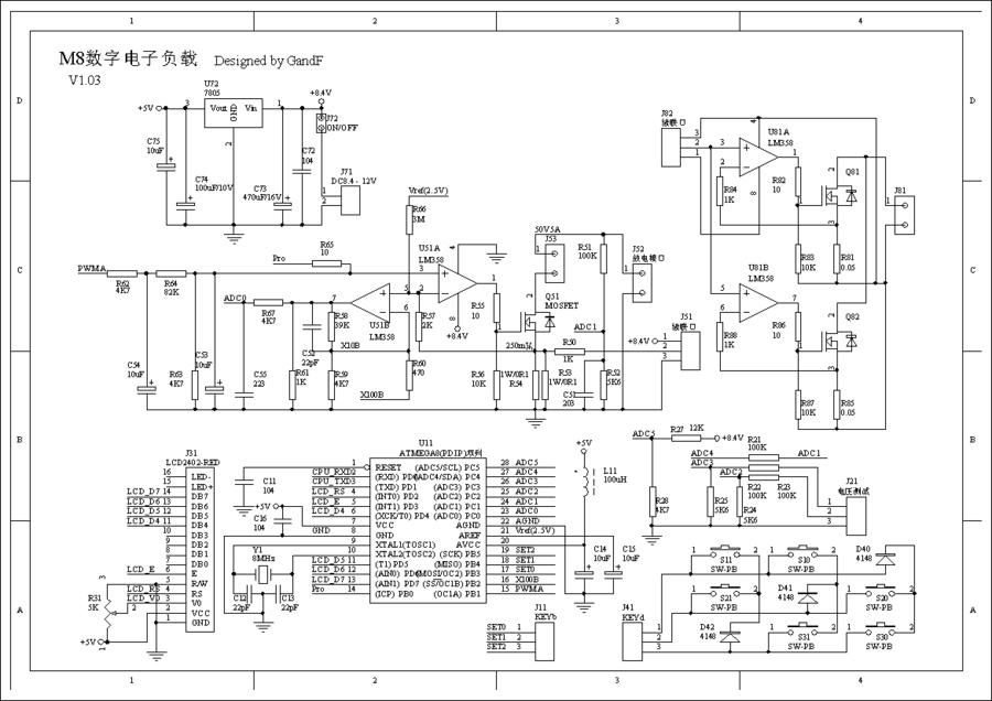

Hello.
Help me please.
How did you get the opportunity to load current over 5 Amperes.
I have a setup with an increase of more than 5 amps of current board does not do anything. It does not set the current more than 5 amps while the power LED displays and 10 amps and 15 amps.
You have used the original firmware or modify it? I have a board with such a display as you (2004), can help me with the firmware under 15 or 30 amp extension?
I have tried to describe your problem in the subject - M8单片机恒流型数字电子负载
Regards Andrew.
发表于 2014-12-29 07:26 | 显示全部楼层
Here is my attempt to describe the problem -
I'll try to explain once again.
No problems getting the output current of 15 amperes.
If I add two gain stage current, the current will be 15 amperes.
But when you install the current, the indicator will be displayed only 0-5Amper.
When you change the current in the range of 5-15 amps, the processor does not change the output, since the PWM output PWM is already 100%.
The problem occurs when you set up the necessary current.
Set current      PWM (PWMA)       Voltage op amp comparison
On display     On pin PB1 MCU         Pin 3 U51A (LM358)
0.000As            0%                                  0 V
1.000As            20%                                0.05 V
2.000As            40%                                0.10 V
3.000As            60%                                0.15 V
4.000As            80%                                0.20 V
5.000As            100%                              0.25 V
6.000As            100%                              0.25 V
15.000As          100%                              0.25 V
Even if I add the gain of the current (as in the diagram above), then I get 15 Amps current. But I have to display the current will be less than 3 times, because the change occurs only in the range of adjustment 0-5Amper all.
Adjusting the PWM and the input voltage of the operational amplifier should look like -
0.000As            0%                                  0 V
3.000As            20%                                0.05 V
6.000As            40%                                0.10 V
9.000As            60%                                0.15 V
12.000As          80%                                0.20 V
Then the adjustment range is fully used.
In a range of settings (no measurement) 5-15 Ampere current MCU does not change anything on pin PWMA (PB1).

发表于 2014-12-29 09:21 | 显示全部楼层
No problems getting ...
修改电流取样电阻。5A是0.05Ω 15A是0.015Ω。您电流取样电阻套件里面是按照5A电流配置的。固件支持15A,但是电流取样电阻在5A电流以上时候端电压超过了0.25V,所以调节没有反应。
发表于 2014-12-29 15:37 | 显示全部楼层
Thanks for the reply.
I plan to apply this scheme to increase the current (top right stage 2).
But as the processor know that I have added transistors, and will be adjusted PWM full range of 0-15 amps.
After all, if I add additional transistors, the resistors 53 and 54 will have to leave with the same resistance.
The voltage at terminal 5 U51B remain unchanged.
How does this work?
