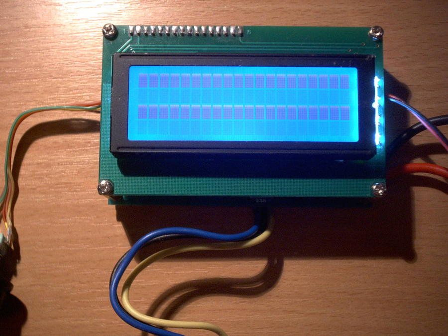

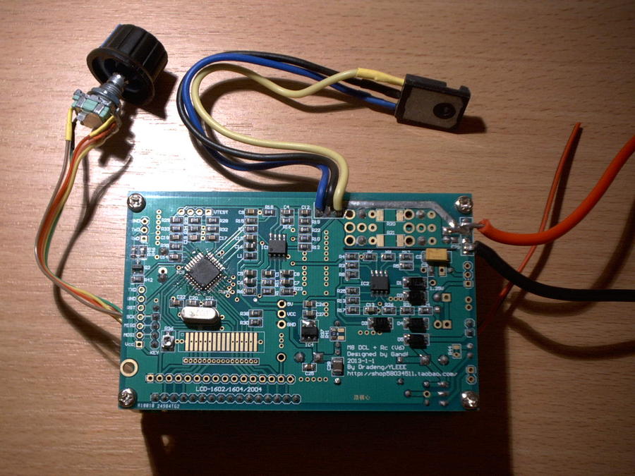

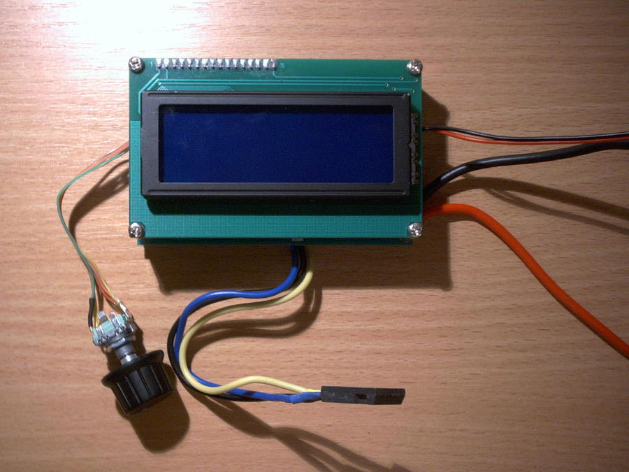

Hi, my name is Andrew.
Bought a load of electronical M6 M8. But accidentally brought it down, very similar to the failure of the processor.
The processor can set a new one, but I do not have the firmware for it.
Help please.
I have a board with 2004 display and encoder
Designed by Gandf 2013-1-1
By Drageng/Yleee
M8 V6
GandF, how can I contact you?

Thank you, but I have a board version 6, does it fit the program from version 7?
And display 2004
My board
And now displays :(

发表于 2014-12-26 17:16 | 显示全部楼层
Tried to write firmware without having to replace the processor.
All perfectly worked.
Why has deteriorated previous firmware is unclear.

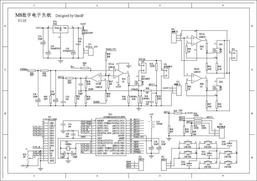

Now plans to make more power, but also would like to replace the shunt resistors for current sensor ACS712
Has anyone done this?

Excuse me, can I have a current firmware 15A ± 15mA and (or) 30A ± 30mA?
I would like to make the device more powerful with multiple FETs and operational amplifiers.
The now firmware  -
0-5 Amps
0-0.25 volts
5-15 Amps
0.25-0.25 V
right after
0-15 Amps
0-0.25 V or
0-30 Ampere
0-0.25  V PWM?
I will use this circuit current gain -
