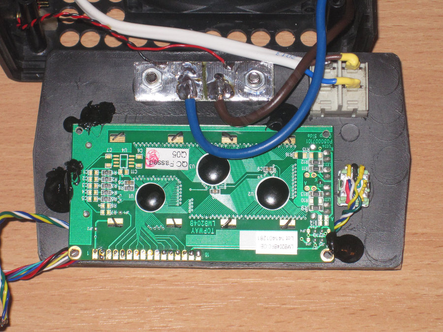

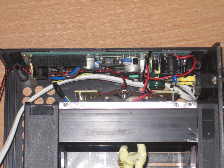

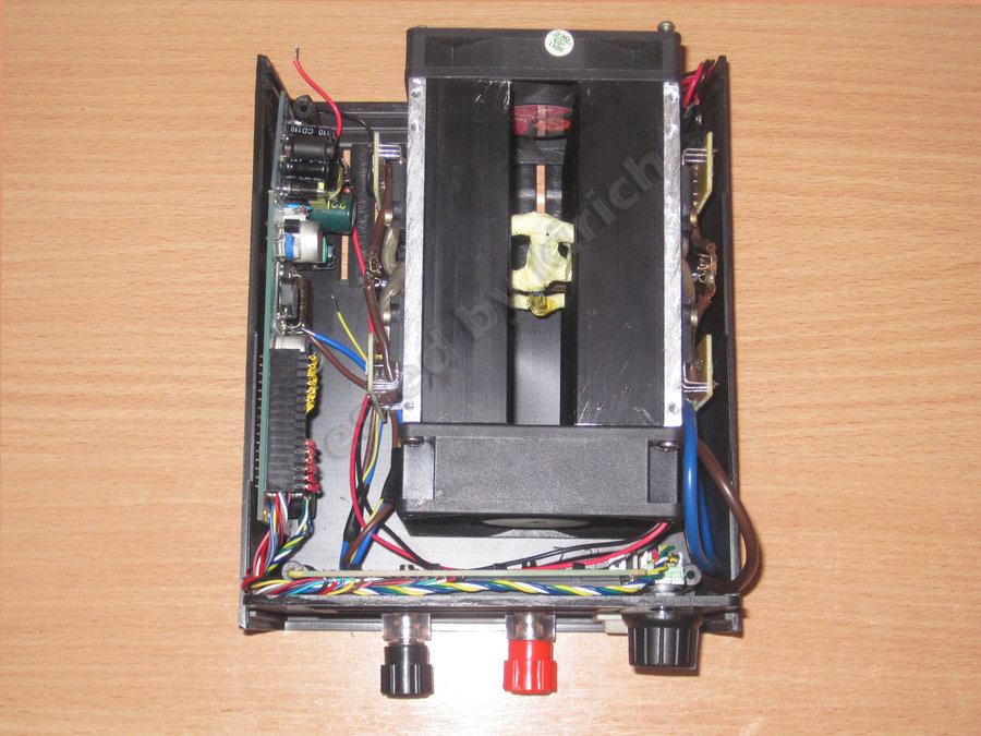

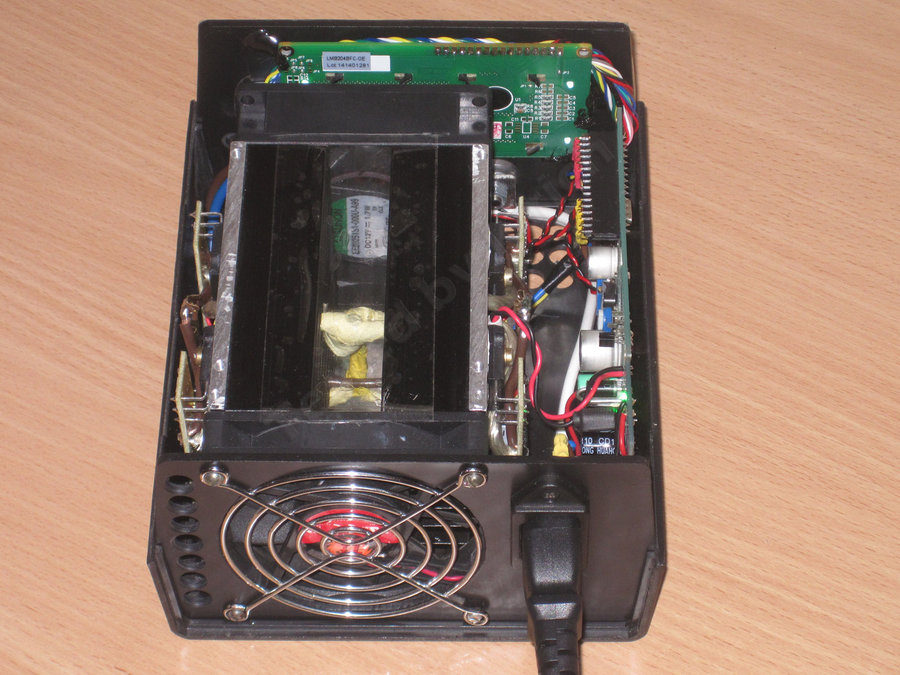

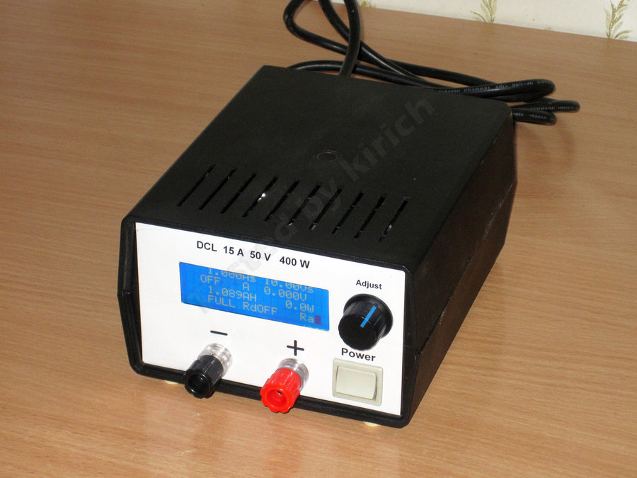

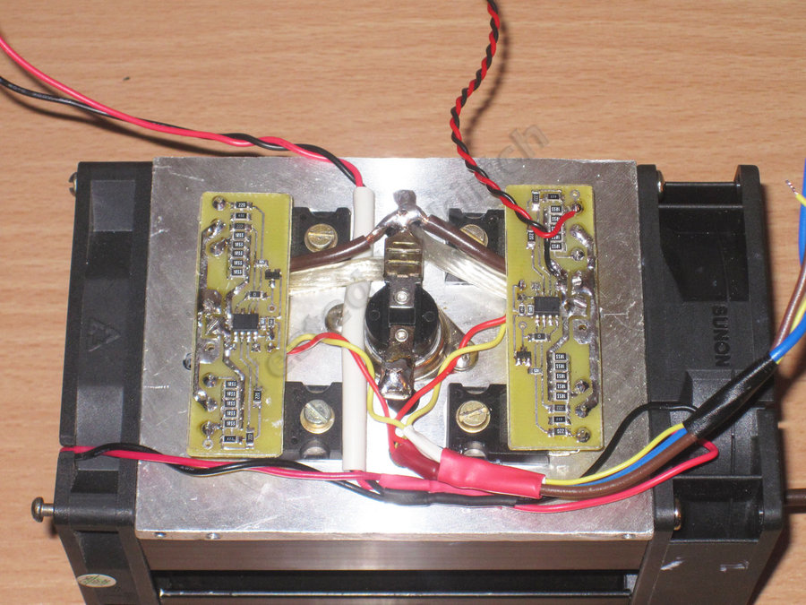

发表于 2015-9-18 19:35 | 显示全部楼层

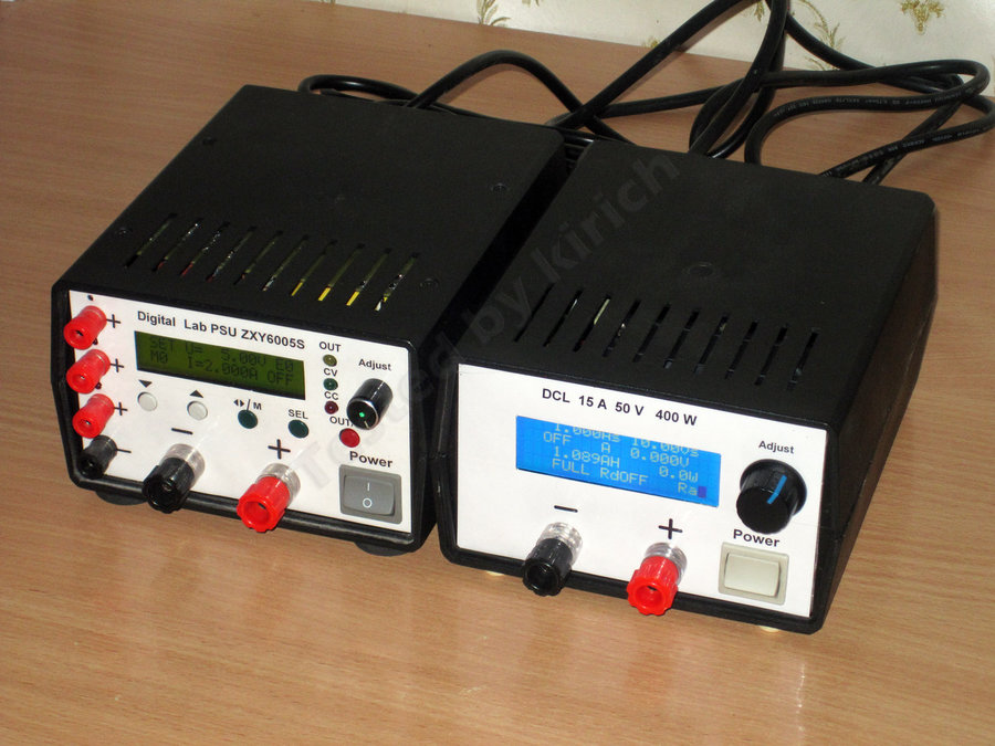

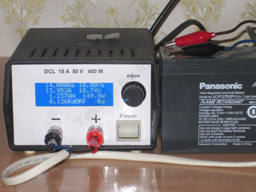

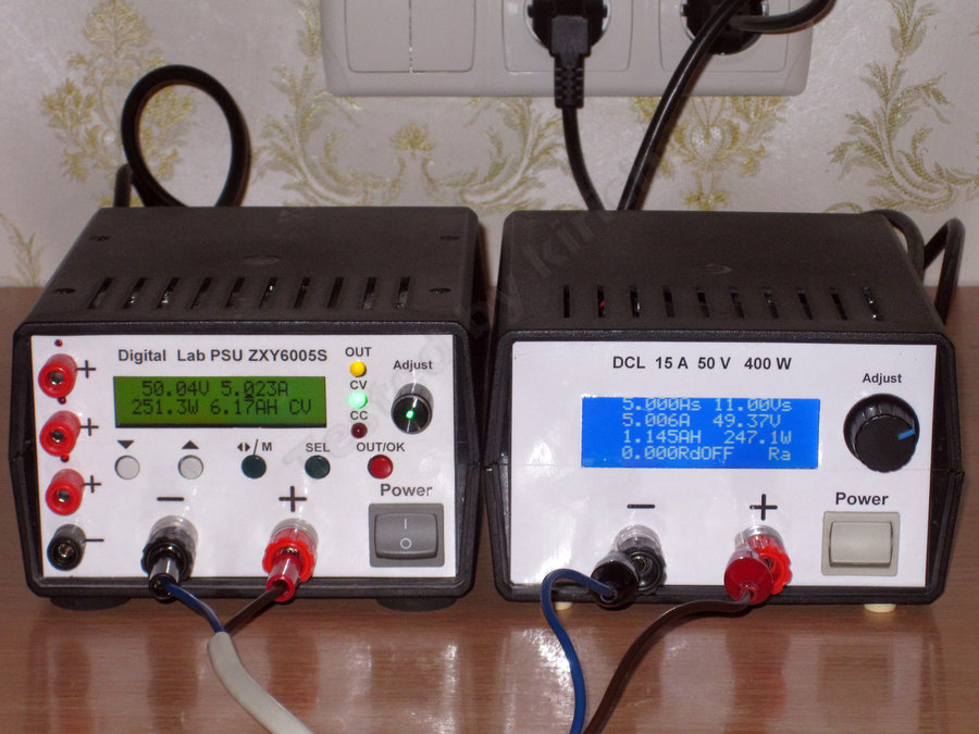

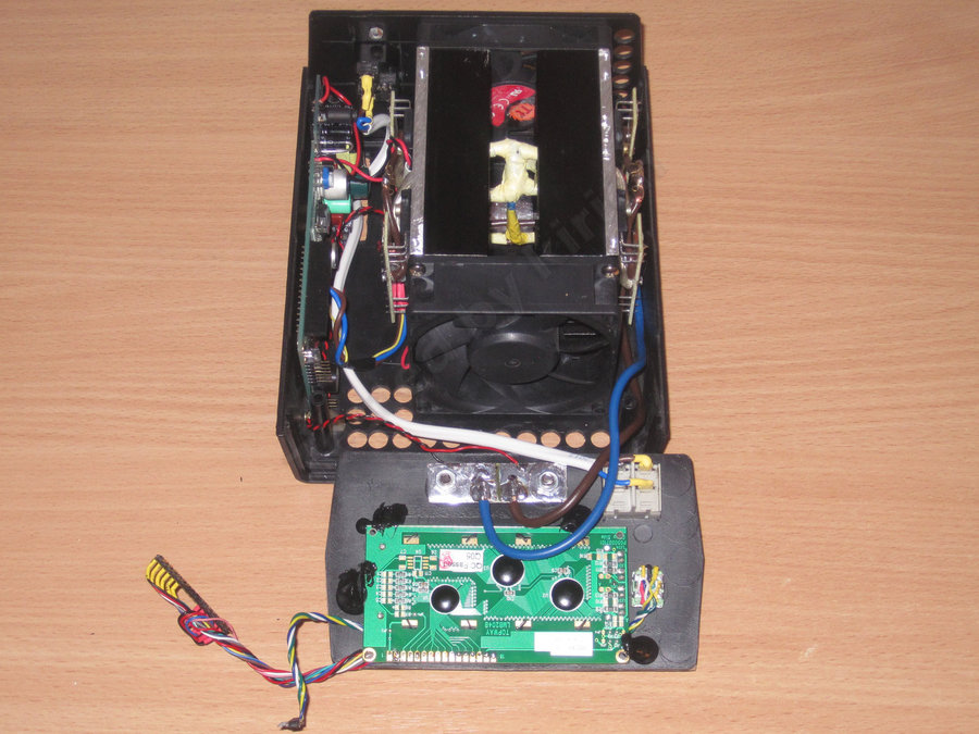

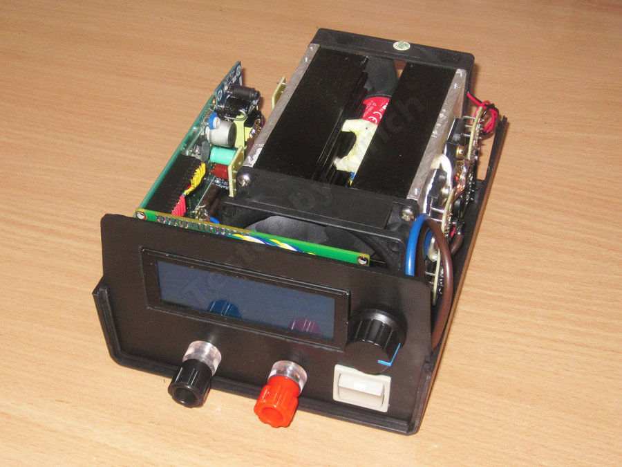

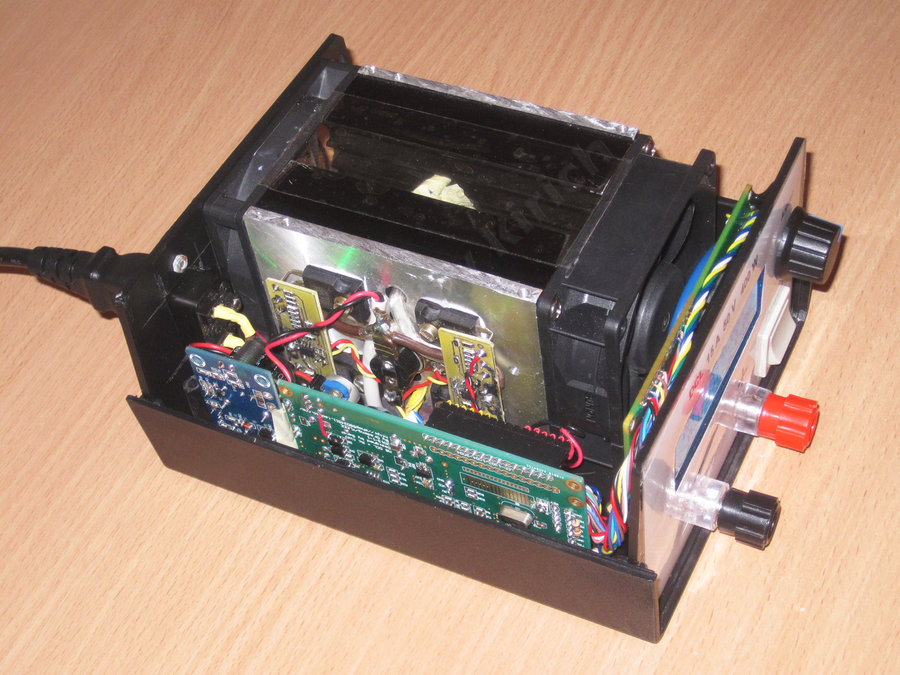

If anyone is interested, here is my version of the implementation of the instrument.
Current up to 15 Amps (can somebody share firmware of up to 30 amps).
Maximum power of 400 watts.
