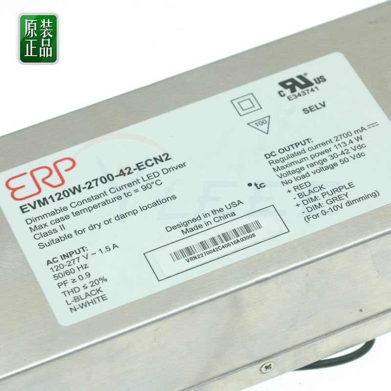

ERP EVM120W-2700-42-ECN2 Dimmable LED Driver输出电压30 – 42V 2.7A,0-10V调光投光灯
价格¥230.00
无货
防水!高效率!长寿命!小体积!
尺寸144 x 70 x 40 mm,输出电压30 – 42V,调光方式电压0-10V,调光范围1-100%,寿命:50000小时,线性0-10V调光的传递函数:10v = 100%,1v = 10%,0.1v = 1%
Features
•Compatible with TRIAC (forward-phase or leading-edge) / ELV (reverse-phase or trailing-edge) and 0-10 V dimmers
•TRIAC dimming only at 120 Vac
•Outdoor surge protection: 3 kV line to line/6 kV line to earth
•Linear 0-10V dimming transfer function: 10V=100%, 1V=10%, 0.1V=1%
•Protections: output open load, over-current and short-circuit (hiccup), and over-temperature with auto recovery
•Conducted and radiated EMI: Compliant with FCC CFR Title 47 Part 15 Class B (120 Vac)/Class A (277 Vac) and EN55015 (CISPR 15) at 220/230/240 Vac
•Complies with ENERGY STAR® luminaire specification and DLC (DesignLight Consortium®) technical requirements
•IP20-rated Bottom Leads with Studs metal case with silicone-based potting. Optional IP64 metal case with side leads
•Lifetime: 50,000 hours
•90°C maximum case hot spot temperature
•Class 2 power supply (only some models)
•Double-insulated power supply between input and output (class II)
厂家资料网站http://www.erppowerllc.com/en/products/constant_current_led_drivers/evm-series
