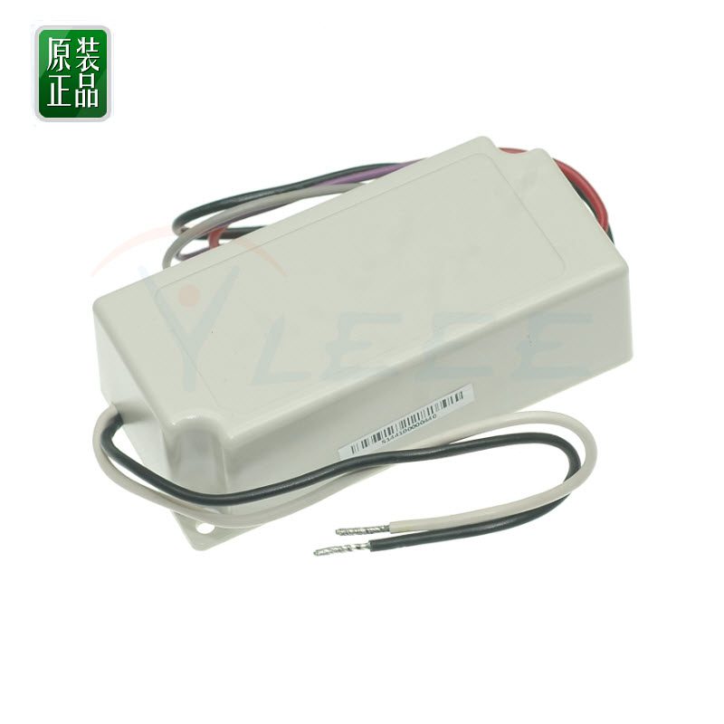

LED调光驱动器ESS030W-0700-32输出电流700ma电压21–32V
规格
类型 恒定电流
拓扑 AC DC 转换器
输出数 1
电压 – 输入(最小值) 120VAC
电压 – 输入(最大值) 277VAC
电压 – 输出 21 ~ 32V
电流 – 输出(最大值) 700mA
功率(W) 29W
调光 模拟,ELV,双向可控硅
特性 OCP,OTP,SCP
等级 IP20
工作温度
效率 90%
端子类型 导线引线
大小/尺寸 3.93″ 长 x 1.02″ 宽 x 0.93″ 高(99.8mm x 26.00mm x 23.7mm)
价格¥125.00
库存 137 件
厂家资料
http://www.erppowerllc.com/en/products/constant_current_led_drivers/ess-series
LED调光驱动器,型号ESS030W-0700-32输出电流700ma电压21–32V
尺寸84 x 40 x 25.2 mm,重量110克,0-10V是调光信号,不是驱动输出。
无标签版本,但型号是正确的。
ess-esst-series-1-pager
Features
  • Compatible with TRIAC (forward-phase or leading-edge) / ELV (reverse-phase or trailing-edge) and 0-10 V dimmers
  • TRIAC dimming only at 120 Vac
  • Linear 0-10V dimming transfer function: 10V=100%, 1V=10%, 0.1V=1%
  • Lifetime: 109,000 hours at 70°C case hot spot temperature (57°C ambient temperature) for ESS030W-0620-42 (26 W)
  • Protections: output open load, over-current and short-circuit (hiccup), and over-temperature with auto recovery
  • Conducted and radiated EMI: Compliant with FCC CFR Title 47 Part 15 Class B (120 Vac)/Class A (277 Vac) and EN55015 (CISPR 15) at 220/230/240 Vac
  • Complies with ENERGY STAR® luminaire specification and DLC (DesignLight Consortium®) technical requirements
  • IP64-rated case with silicone-based potting
  • 90°C maximum case hot spot temperature
  • Class 2 power supply
  • Double-insulated power supply between input and output (class II)
