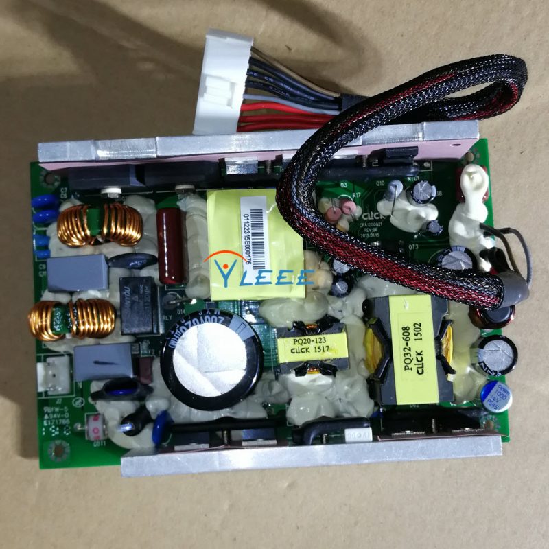

Application range: Communications industry
Product Features:
► Universal AC Input / Full Range
► Built-in Constant Voltage Circuit
► Protections Mode: OVP, OCP, Overload / Short Circuit, OTP
► PCBA with Conformal Coating
► Double Insulation, High Insulation Voltage Ensure Safety Usage.
► High Efficiency and Low Noise Characteristics
Dimension (L*W*H) 152.4*100.6*29mm
输出电压12V
输出电流10A
功率120W
华为通讯电源
CLiCK全新原装CPA1200021I 12V10A YM-1131F PA-1101-1H-LF通用
价格¥350.00
Electrical Parameter Environment & Safety Specification
Input Voltage Range 30-90Vac Operating Temperature -40℃~65℃
Input Frequency 50/60Hz Storage Temperature -40℃~ 70℃
Power Factor >0.9 Storage Humidity 5~95%
Turn on Delay(s) <3 Cooling Mode Natural Cooling
Rated Output Voltage / Current 12Vdc/10A MTBF ≧250,000Hrs @25°C  (Telcordia   SR-332)
Output Voltage Tolerance <±5% Surge Voltage CM:±6kV, DM: ±6kV;
Dynamic Overshoot <±5% Insulation Voltage 3KVac @ Primary v.s. Secondary
Ripple and Noise (Vpp) <240mV Insulation Resistance >10Mohm @ Primary v.s. Secondary @ 500Vdc
Efficiency (%) >89% Safety Mark & Standards Complicance EN60950, CB, CE, TUV, UL&cUL
Rise Time <200mS EMC & EMI Standards Complicance FCC Part 15 Class B; CISPR 22
Hold up Time >20mS Dimension (L*W*H) 152.4*100.6*29mm
当作电动车DC-DC用的12V也是很不错的。
